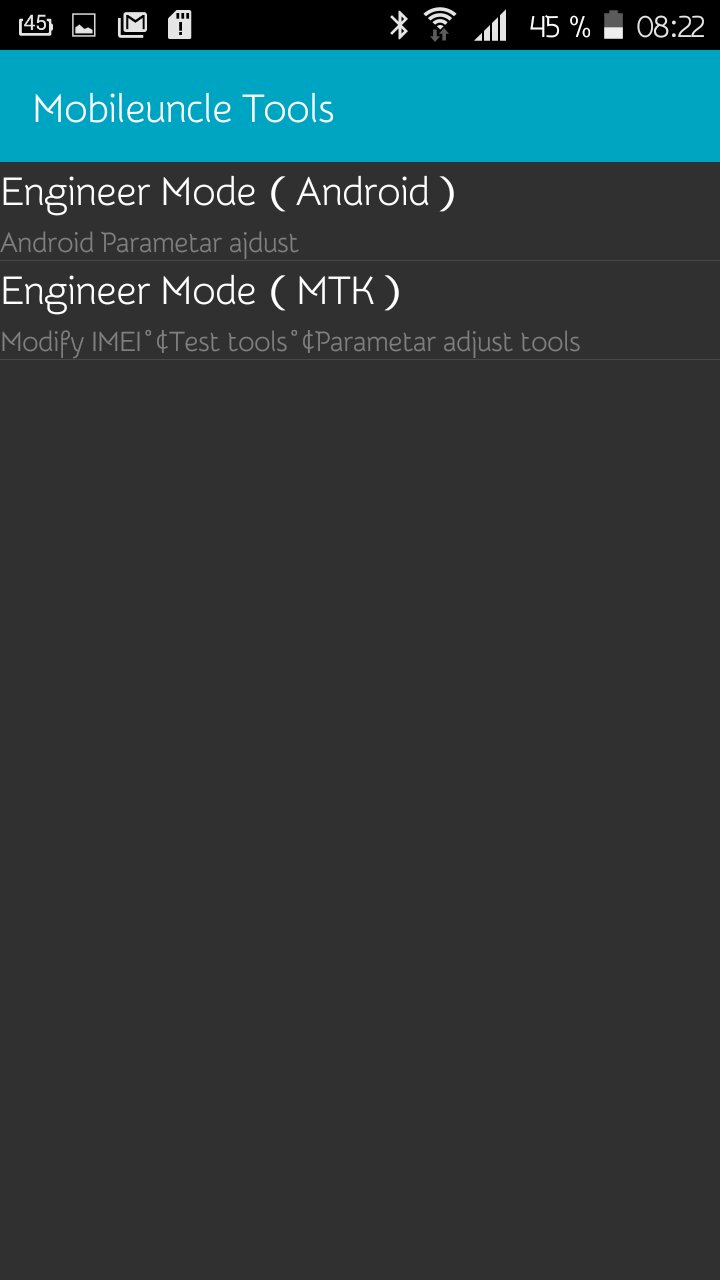

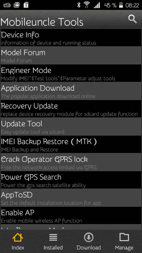

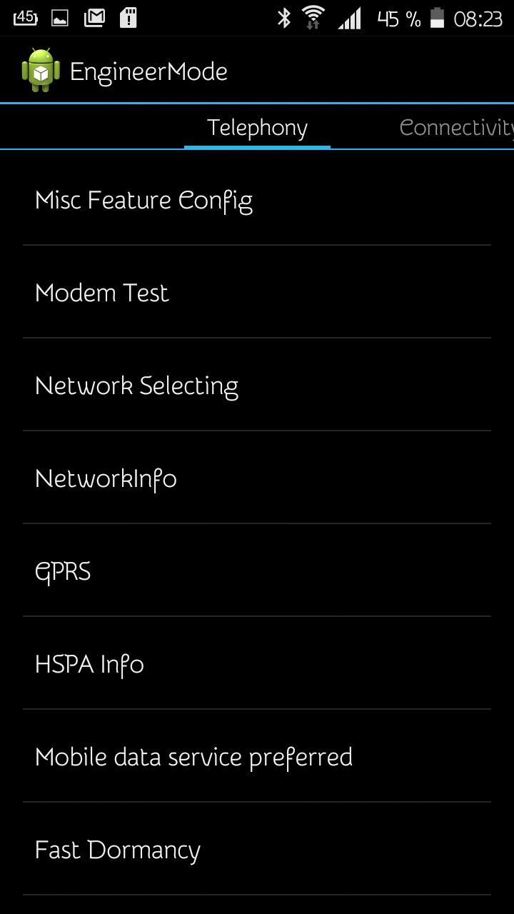

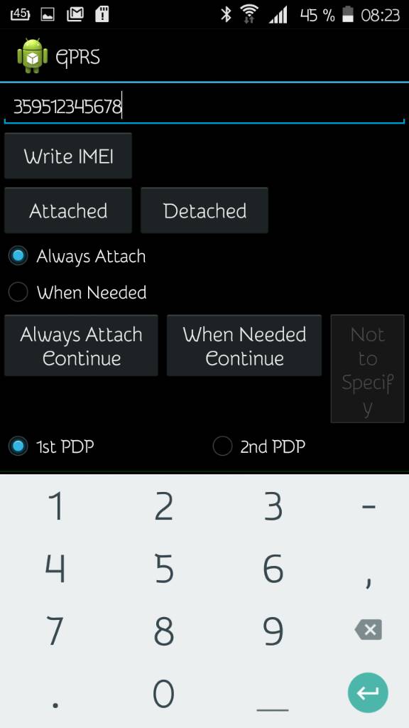

Maybe i can help , install mobileuncletools from playstore ,
then open
Open MTK engineer
Hit GPRS ,
Write your imei
Restart your phone
Maybe you need root , but not must have on other devices
Greetings
